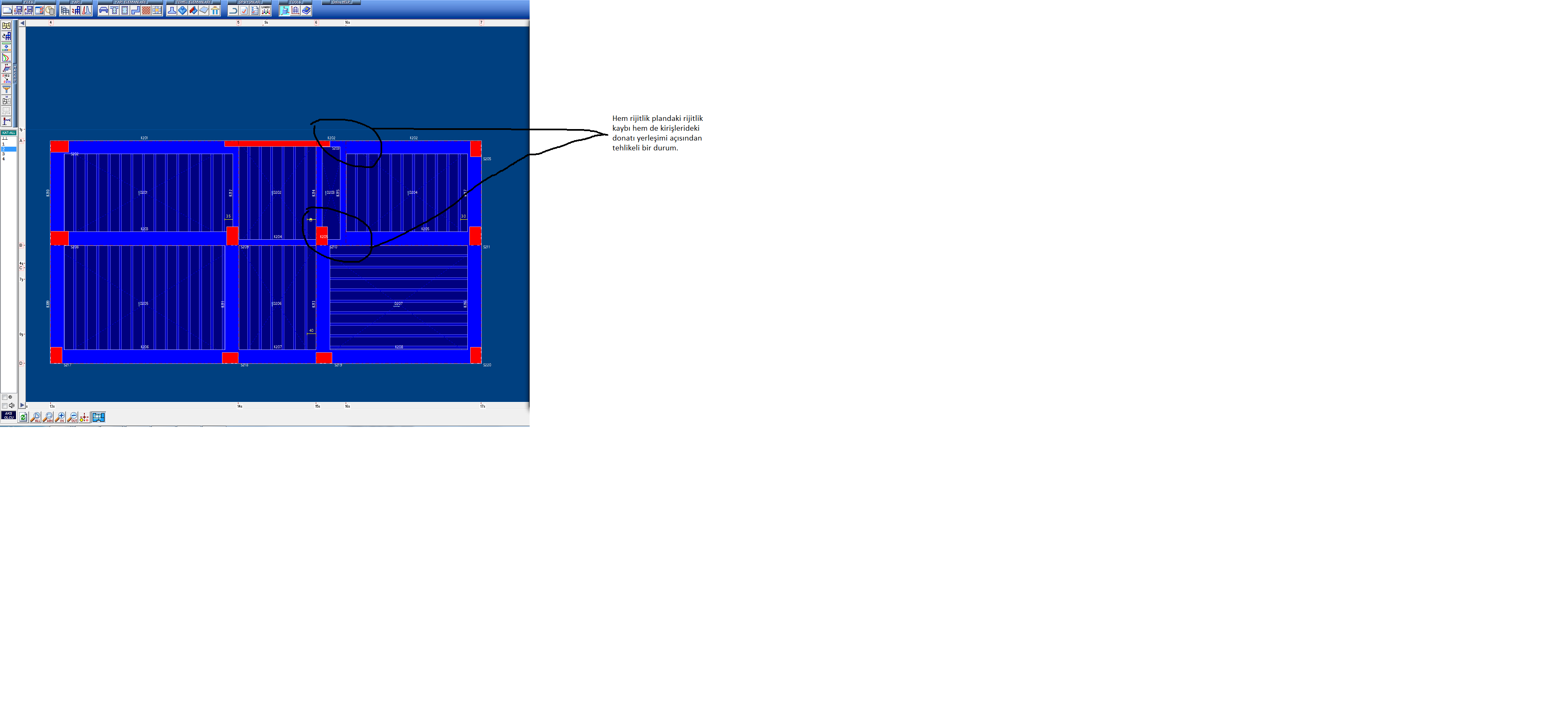

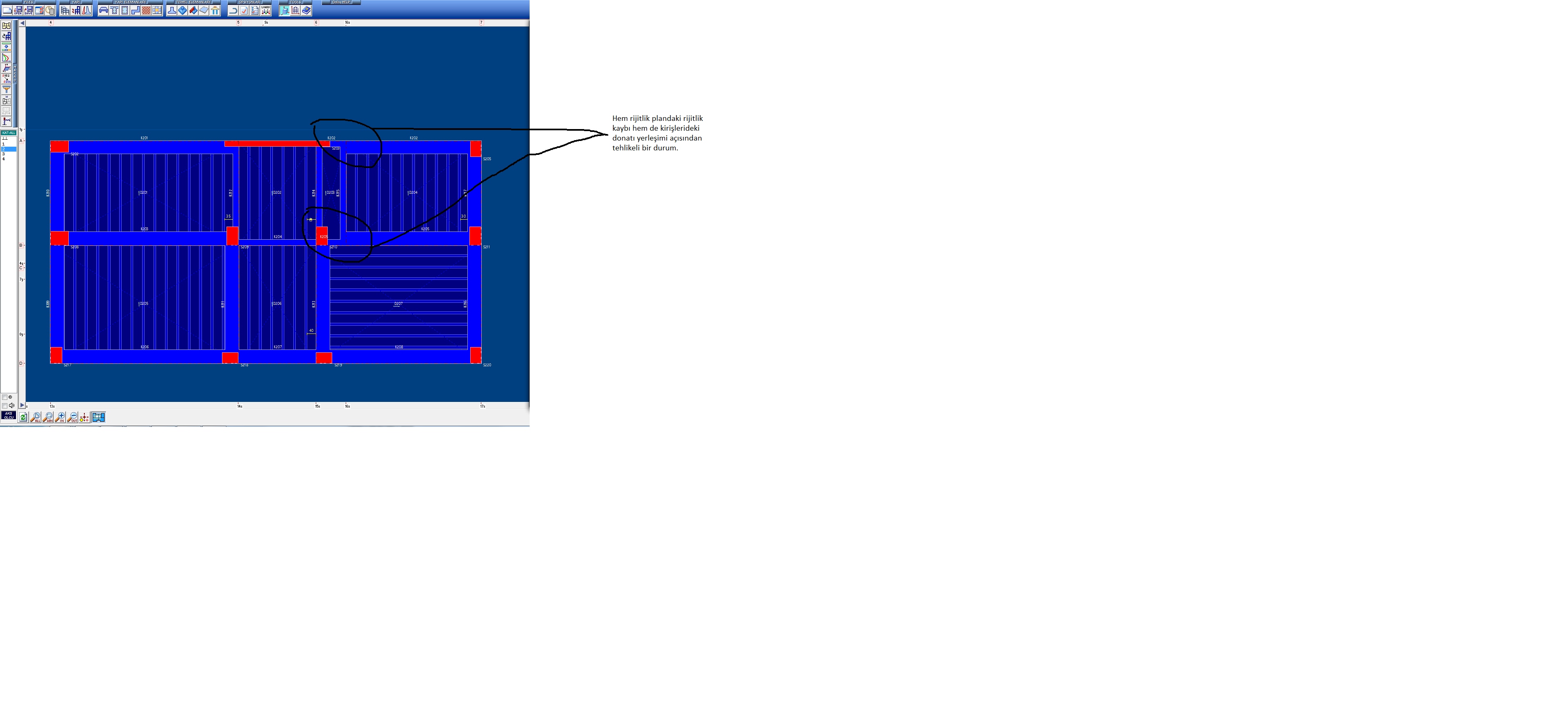

mhmmd.lksz
Click to View Image897 View(s)
